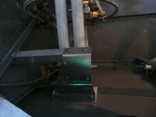

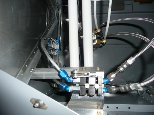

Made bracket to hold Matco park brake and plumbed. I had two flexible stainless brake hoses made to go from the master cylinders to the park brake. The two hoses supplied by Van's were too long for this installation.

Top down look at park brake bracket
Finished park brake installation
