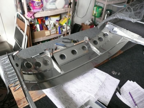

Brief Description:  Canopy frame prep work
Canopy is now back on the bench. Removed the skin and started work on the canopy reinforcement bracing. First, I had to bend the lightning hole flanges, then clamp the bracing in place, drill the frame and skin, and make 6 clasps for the outboard braces.

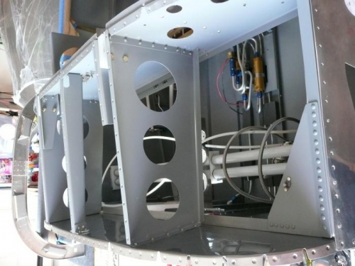

With the forward fuselage skin now removed, I did the final riveting of the forward ribs and structure to the fuselage.
Reinforcement Bracing Layout
Fwd Fuselage final riveting
