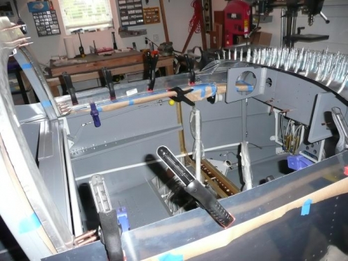

Brief Description:  More canopy frame fitting
Did more adjusting on the 631 frame supports. Predrilled the side rails to the forward canopy frame along with wedge spacer.
The 7/8" spacers between the 631A frame supports and the roll bar seem to be too much; leaving a good 3/8" gap. Will have to make some 3/4" spacers to bring the gap to 1/4".
Fitting side rails
Fitting side rails
