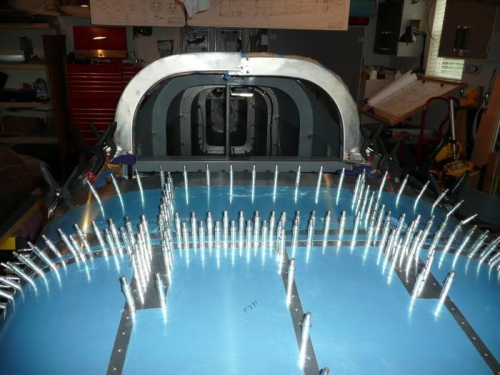

Continued fitting the WD 716 forward canopy frame. Reached a point where the fit looked good with a reasonable gap separating the 702 and 771 skins. I made sure the fwd canopy frame would open and close without interference and then drilled the hinges and installed the bushings.
Part of the frame fitting
