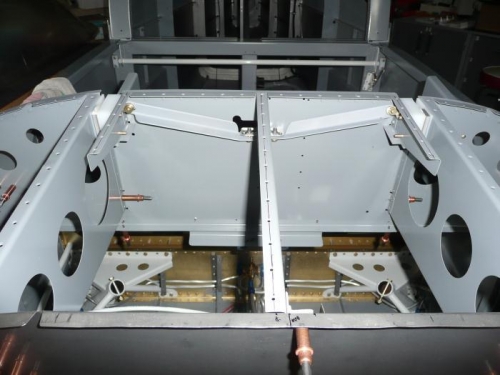

Riveted F705G-L&R to F705F channel, F757 Gusset, and F718 Longeron in preparation to install F631 Cabin Frame assembly.
Did not use the F697 channel and release mechanism; but installed the option depicted in photo #1 below. This can be easily reached whenever the canopy needs removal.
Installed steel braided brake lines from M/C to firewall junction.
Installed top forward skin and match drilled, deburred and dimpled forward ribs.
Optional canopy realease installation.
