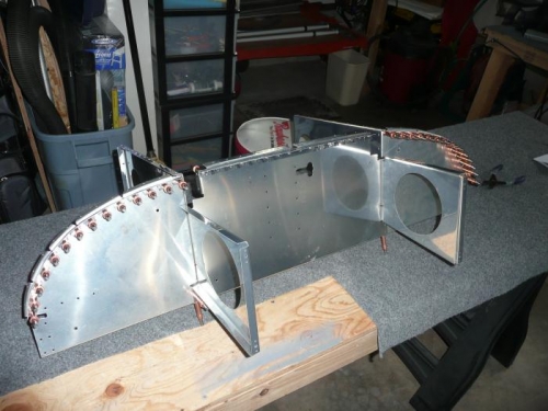

Worked on forward fuselage pieces getting them fitted, match drilled and dimpled. Made the F-703B angle and riveted to the back side of the instrument panel. Made all the seal support angles for the seal strip and riveted them to the center and outboard F-768 bulkhead pieces.

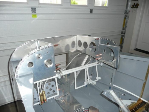

I cut the F-745-L forward fuselage rib to make room for the 10"Skyview EFIS. Will move the cut piece right and add any additional support as needed.
This is where you have to have a pretty good picture of your dash arrangement before proceeding too fast with final riveting and installation.
Seal support angles
Seal support angles
Fwd Fuse assembly with F-745-L cut
