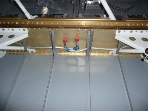

These 12 hours include work on April 3 and 4. I managed to get the main gear leg mounts installed. I prosealed the outlet area on the bottom skin to seal out the elements. One thing I found was that Van's call-out on the bolts attaching the mounts to the center support bulkhead were too short. Bolts only came flush with the nylok nuts. I will have to order one size longer from Van's and re-install later.
I also installed the fuel lines from the injector pump to the outside of the fuselage. This was more difficult than expected and required much more time than expected, also.
Ready for pump install
