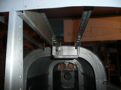

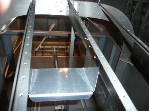

Made a mounting bracket for the ADAHRS unit and installed at the top of the fuselage just behind the baggage area. This seems to be a popular location and it should be about 2 feet away from any other electrical disturbances.

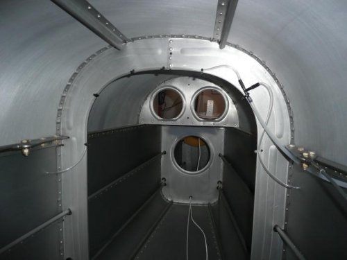

Static line
Static line
