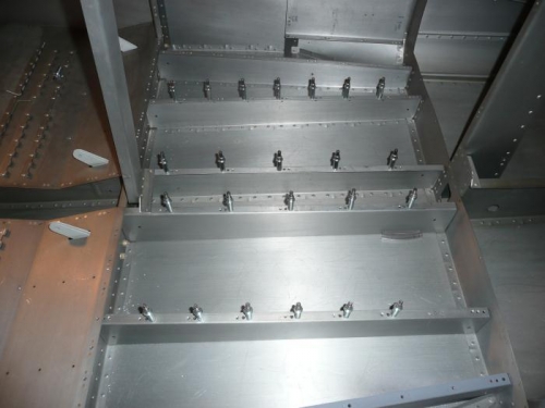

Started the day deburring, dimpling and priming the inside of the forward aft skin and storing it in my office until later. It needs to be off for access to the interior area of the fuselage.
I installed the rudder cables. I used some tubing from the rudder pedals rearward to the aft side of the baggage area (photo #1). I also installed the previously finished bellcrank and elevator push rod (temporarily, maybe). I hope to install the empannage soon and get it set up; but will probably also have to remove it afterwards.
After removing all the floor plates in the seating and baggage area, I decided to install nutplates so that the baggage area covers (picture #2) could be easily removed to inspections. Lots of extra work, but worth it in the long run.
