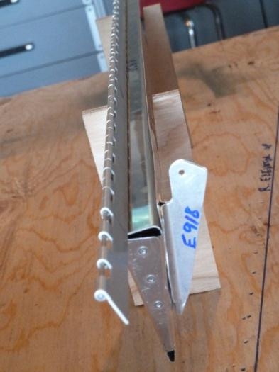

Today was spent putting together the trim tab for the left elevator. I have elected to go with electric trim and will install the trim motor and gear later; even though I have already purchased the electric trim kit.
This took a little more time than I thought for such a small piece. Some tight quarters to work in. I had to make a bending brake to put a final bend in the trailing edge of the tab. I now have it completed with electric trim tab rod attachment on. The hinge is riveted to the tab spar and ready to attach to left elevator.

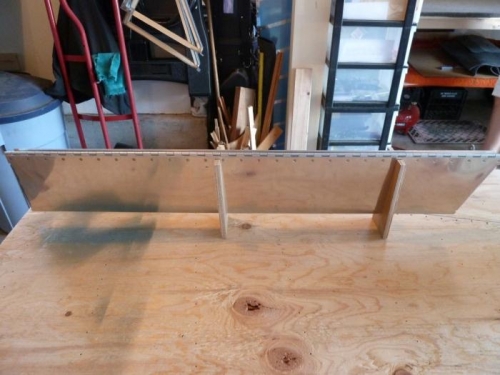

"V" wedges to secure foam ribs inside for drying.
Pretty staight
Pretty staight
