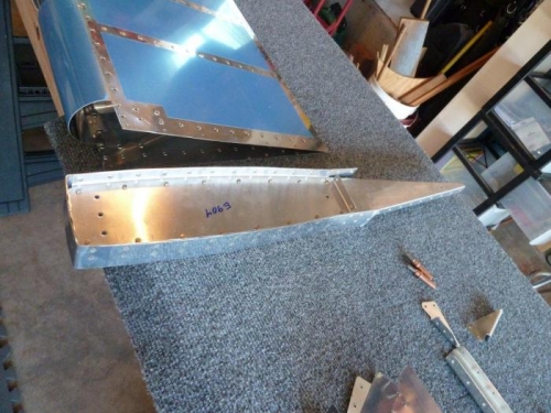

Brief Description:  Left elevator assembly
Back rivited the skin stiffeners to the left elevator skin. Assembled the counterbalance ribs and riveted the counterbalance skin to the ribs. Riveted the the reinforcement plates and nutplated to the spar. riveted the elevator horn to the skeleton assembly.
