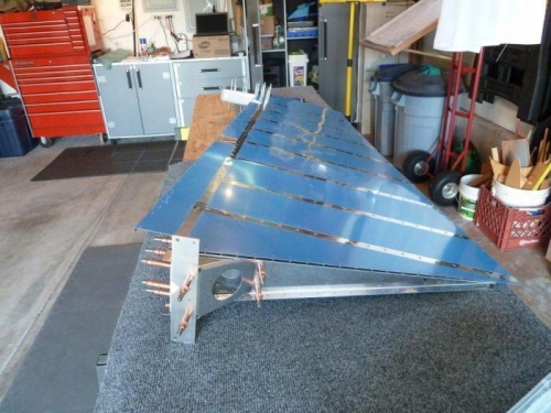

Brief Description:  Rudder pre-assembly
Primed, then riveted the stiffeners to the rudder skins this morning. Assembled the rudder skeleton, attached skins. Match drilled all holes in skeleton. Assembled the skins onto the skeleton and have it ready for match drilling, deburring, dimpling and final assembly.
