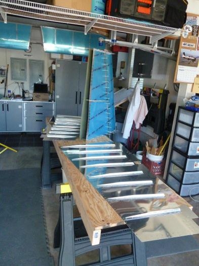

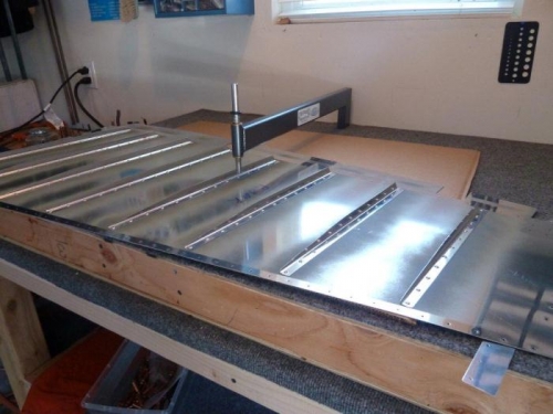

Started on rudder today. Cut and trimmed 16 stiffeners for the rudder skins. Clecoed and matched drilled skins and stiffeners, deburred and dimpled all. Primed under side of stiffeners and along each row of dimpled holes. I will prime the entire inside of the skin and rudder skeleton before final assembly.
Primed under stiffeners and along attaching holes.
rudder skin layout with partially completed VS
Rudder skin waiting for riveting.
