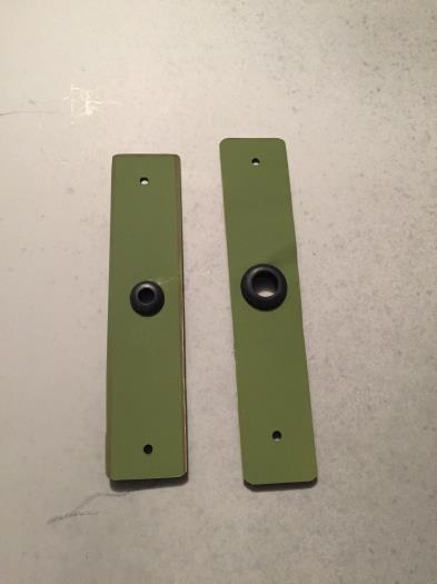

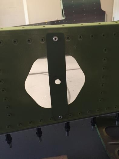

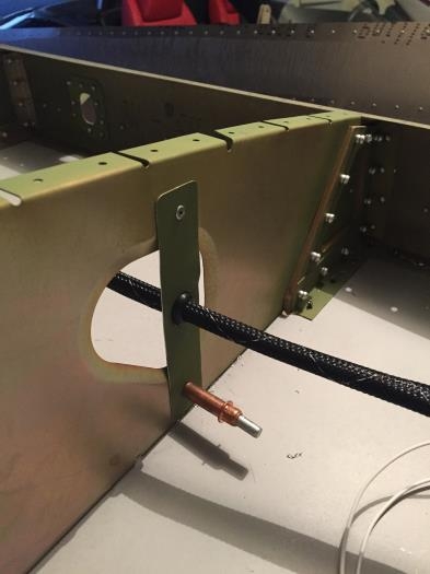

Wire bracket
I made few brackes to hold the wires in place, this and some shrink tubing does a good job keeping the wire in place. I also used one for the wires going to the landing lights. Had to removed 2 rivets from it, and riveted back with the bracke.
