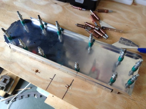

While my band saw has been down for a couple of weeks, I had to hack saw my way through this piece. I had acquired the pre tapped versions of this piece from Cleaveland Tools. They make life a bit easier. I cleaned up the edges on the linisher and finished all the edges on the scotchbrite. Ready to Prime...
Deburring of the Bulkhead components F1012A and B is easy as they are very few parts that cant be reached by the scotchbrite.

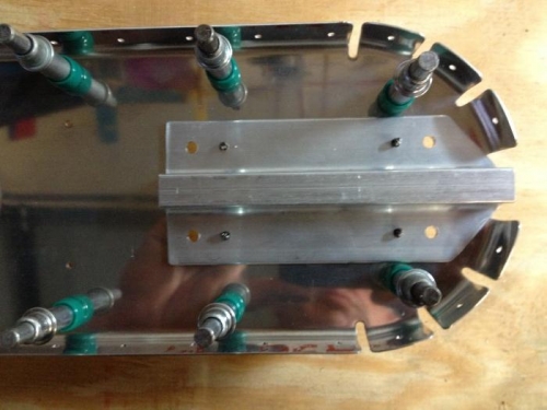

I used a couple of C Clamps to hold the Tie down in place while drilling it.
