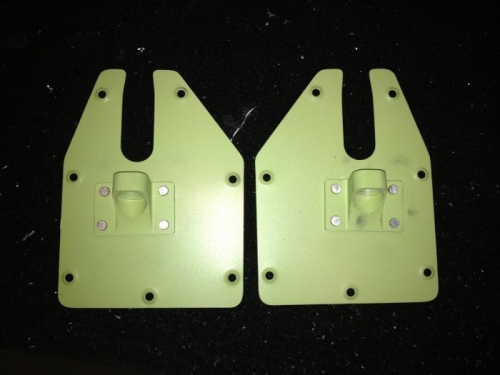

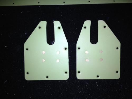

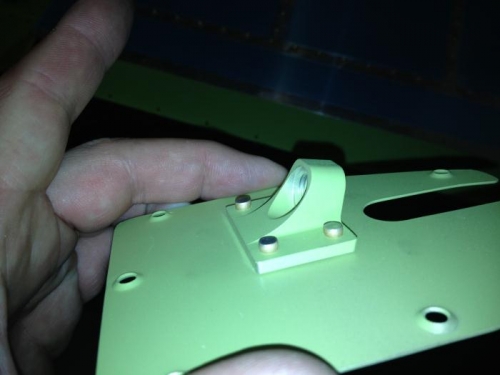

I had chosen to go with the IFLYRV10.com Trim attachment brackets machined from Billet. The thickness of the blck makes it imossible to use the proposed LP4-3s for attachment. Instead, I had dimpled the covers and countersunk the brackets. I then used AN426-AD4-X rivets to attach them.
