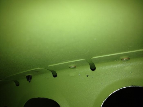

I started work riveting the HS skins this evening. The first task is to rivet the Nose ribs in. There is not a lot of room to work in the skins when clecoed to the rivets. The end ribs on each skin are easy as they can be squeezed. But I had to use the rivet gun on the middle ribs on each side.
Initially, I had no bucking partner, so I was unable to complete the job completely. Instead, I did the top three rivets on each side of the nose ribs. This is the first time I have attempted riveting skins with the gun without a partner, so I took it very very slowly.

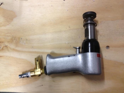

Over Christmas, I purchased an ACAT 2X rivet gun from the Yard Store which I plan to use for all the -3 rivets. It is a lot easier than the 3X gun for these smaller ones.
Another problem is the orientation of the flanges. I am right handed, but was also able to use the 2X left handed, though that is not my preference. Working left handed ensured that I did not get tied up in knots when working on the "other side" of the rib. I would have o say that the quality was roughly the same as myy first rivets on the right hand six months ago... I ended up having to drill out one rivet which will have to be replaced by an oops rivet.

Looks like there is plenty of room, but there is not...
New ACAT 2X from the Yard Store
