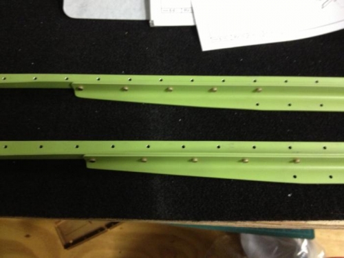

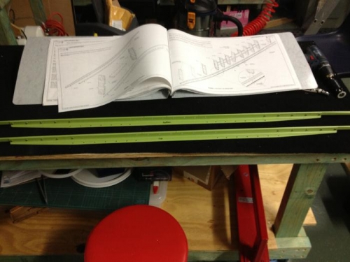

Brief Description:  Countersinking Spars and Stringers
I commenced the countersinking of the stringers and spars today. I set up a jig made from an 8ft length of pine to hold the spar in place. Then I was able to just run up the spar without any problems using the countersink micro stop.
