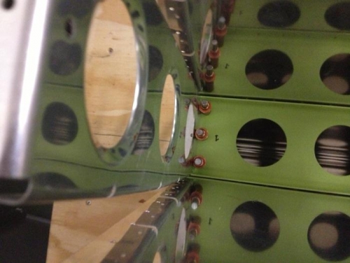

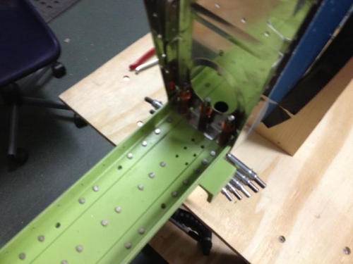

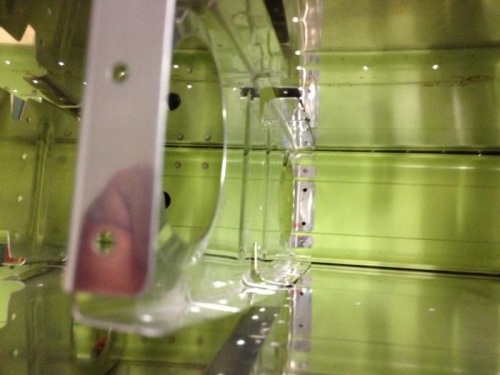

Brief Description:  HS Prep and Drilling of the HS
