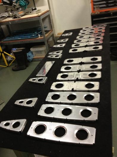

Date:  12-9-2012
Manual Reference:  8.7.1-4
Brief Description:  Modify Inspar Ribs and Nose Ribs
On this page, there has been some modifications to the kit that should be mentioned. If you look at the photos, the nose ribs are prepunched with two lightening holes at manufacture. So there is no way to make the modifications as stipulated in step 4 to allow the trim cables to be mounted. I assume that the will need some other form of stand off to prevent them chaffing on the edges of the rib lightening holes. Most likely an Adel clamp.
Nose Ribs already punched?
