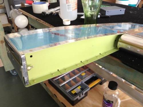

Brief Description:  Finish Rudder Counterbalance

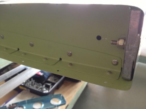

I ran through the complete set of instructions to complete the counterbalance. I had a small amount of pillowing of the skin so as a result, I had to add the additional blind rivet per steps 3-5. I was happy with the overall result and the fairing should blend in pretty well when it comes time to complete it.
Weight in place
Weight in place
From the top rib side
