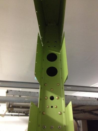

I rolled the leading edge of the rudder using a 33mm woodedn curtain rod as my primary rolling tool. I then used a smaller diameter 20mm rod to "tighten" up the radius in various places. It is very tight in a couple of places, but came out with no creases and looking great overall. Partner was Ryan ...
Before...
Before...
