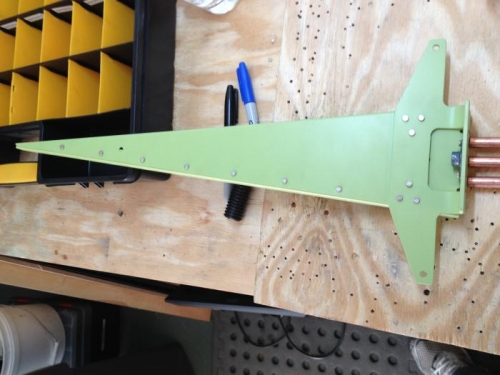

Brief Description:  Attach the Bottom Rib to the Right Skin

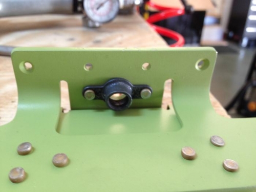

I added the Bottom Rib to the Right Skin. In order to do this, I made a slight change to the construction order, doing step 7.9.1 before doing this step. This is attachment of the shear clips. By doing this, I was able to cleco the spar in place and attach it to the bottom rib. This made the whole assembly much more rigid while working on it. I used the pneumatic squeezer with the 4" no hole yoke. The thin end on this yoke fits into narrow spaces comfortably. Rather than use an AN426AAD3-3.5 for the final rivet closest to the trailing edge on the right and a CCR264SS-3-2 on the left, I decided to be consistent and use CCR264SS-3-2 pop rivets on both sides. I am expecting to not have much room for this, but I think that it willl be an asthetically more pleasing result
Bottom Rib Riveted
Bottom Rib Riveted
Nutplate
Nutplate
Attached to Right Skin
