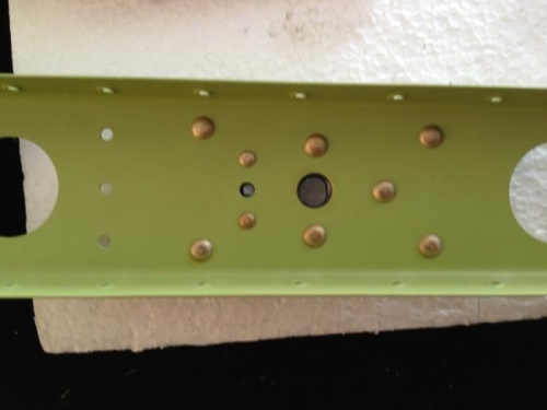

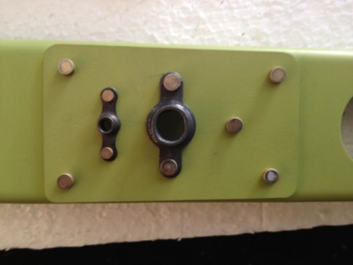

I riveted up the doublers r-607PP and R-608PP I had a bit of a problem with the R-608 in that when clecoed together, I was getting some interference when I tried to insert the hinge bolt MD3614. So I opened the doubler hole up slightly to allow easier access. This is no doubt a slight misalignment from when I remade the doubler.
R608 with Static Bonding Point
Rear Side
Rear Side
