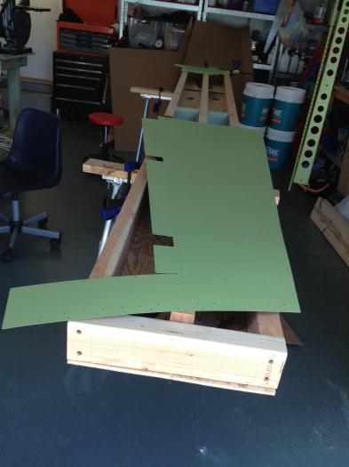

Today I completed the priming by doing the Rudder skins. I ran through the same procedure as yesterday, however, it was very hot and windy today and as a result, the skins dried very fast. I should have increased the paint flow to reduce the speed at which it dried.

The skins turned well
Left Skin
Left Skin

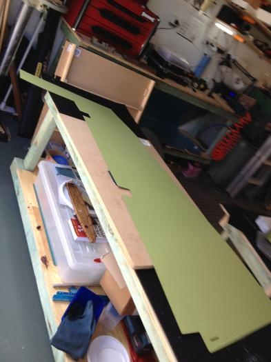

Right Skin
Right Skin

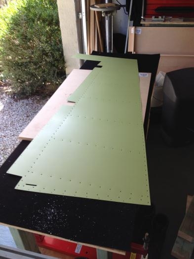

Slightly better view
