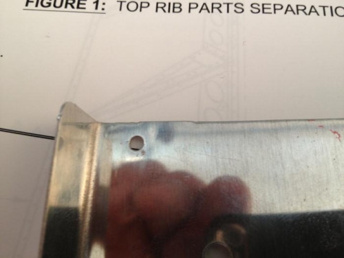

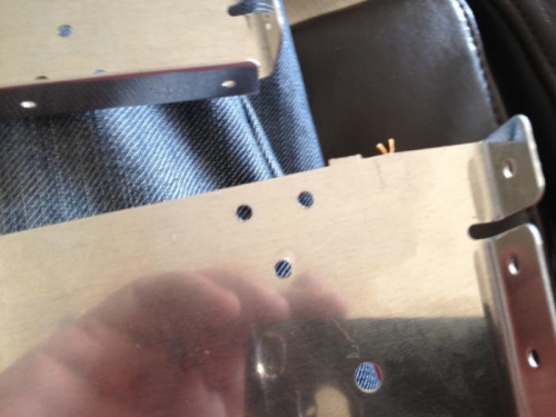

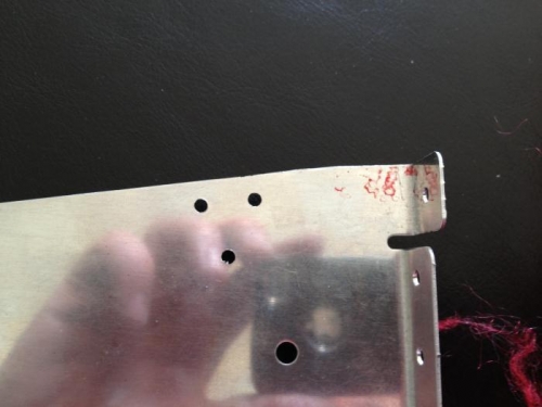

The Edge Distance for the R-1003A and R1003B components is very compromised. Here is the text I put onto vansairforce and the responses I received.
I have commenced working on the Rudder and I am wondering about the edge distance for the parts R-1003 and R-1004. I had completed all the skin drilling and was about to sta
Edge Distance on the R-1003A
Edge Distance on my original cleaned up R-1004A
Edge Distance on a pristine R-1004A has the same problem.
