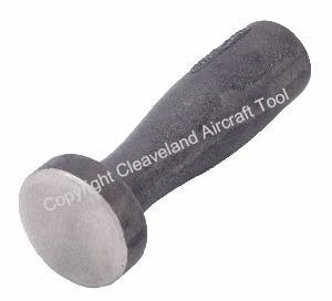

I have also purchased a back riveting bucking bar from Cleaveland: http://www.cleavelandtool.com/prodinfo.asp?number=BB46#.UHTj_RXCaSo .

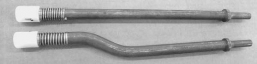

Given that I am planning a slow build kit, I wanted to be able to back rivet as many sections of the wing as possible when in the wing stands. This bar makes it a lot easier as you can use a long back riveting set:
http://www.averytools.com/prodinfo.asp?number=4560
from the inside and have the large surface bar on the manufactured head. My practice using this setp has given very good results so far.
Back Rivet Bucking Bar
Long Back Rivet Set
Long Back Rivet Set
