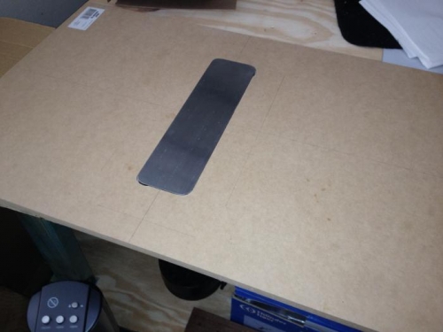

I also routed an 8mm deep hole in a piece of 900 x 600 MDF for my back riveting plate. Routers really are bad news health wise. Routers on MDF are even worse, but they do leave a good finish. I wasnt perfect around the edges as I couldnt see what I was doing half the time, but being slightly loose in 2 places does make removal of the plate a lot easier and it wont move when riveting. The plate is now 0.5mm above the surface of the MDF sheet. Exactly where I wanted it. I was nervous that having it low might result in impressions on the Al if the rivet was near the edge of the plate.

Back Rivet Plate
Back Rivet Plate
