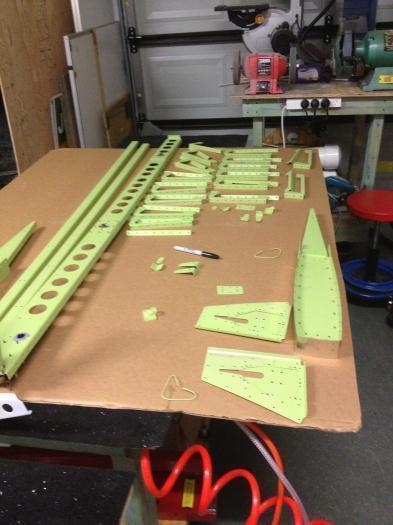

Having completed that task, I got the spray painting gear out and spray painted everything with the Stewarts EkoPrime one pack primer. This went very well with the exception of one part on a trim plate reinforcement sking which I will have to touch up. This time, I made sure that I was working in the shade. I had no problems with dry paint as experienced on the HS. The temperature was a lot lower on this occasion, so I am sure that this would have helped as well.
Many parts with a good primer coating.

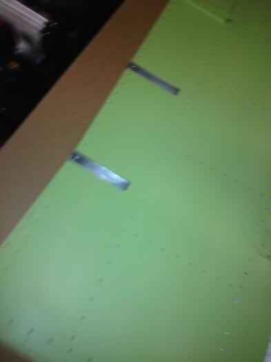

Skin detailing masked out areas

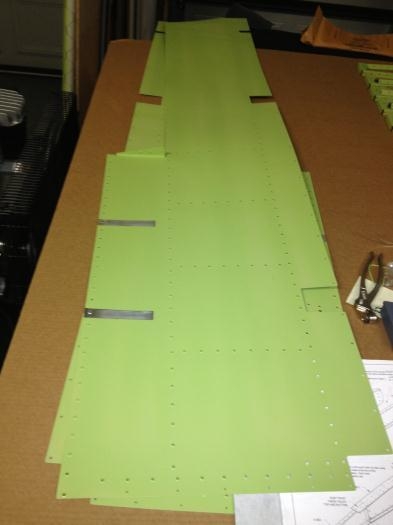

Full Skin
Full Skin
