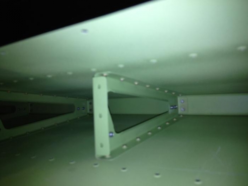

Date:  2-17-2013
Number of Hours:  1.50
Manual Reference:  9.12.6
Brief Description:  Blind Rivet Ribs
This activity should be pretty easy, but if you have big hands, it is somewhat difficult. As you will see when I get to the Right Skin, you can mess it up and if it is deep in the rear of the rib, it is very hard to get the rivet out. All the rivets in this the left skin went very easily which led me into a false sense of security.
