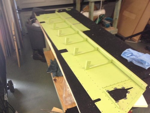

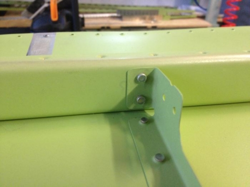

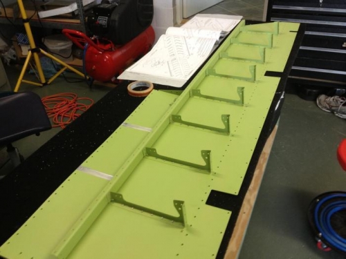

Date:  2-16-2013
Number of Hours:  1.50
Manual Reference:  9.11.4-5
Brief Description:  Adding rear spars and shear clips
Attachment of the rear spar and shear clips to the rib flanges is easy, each of the ribs takes two AN40AD4-X rivets as the attachment. The only area of concern I had was where I have the missing rib which will be added soon. Each of these rivets is squeezed.
