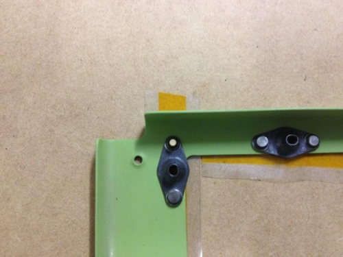

The trim reinforcement plates and their nutplates are riveted sepparately and then attached to the Skin. In this task the nutplates are added. There is fairly tight access to one of the rivets (picture 1) as the back rivet set does not fit between the flange and the core of the nutplate. I ended up driving it with a 1/4 punch and hammer.
This one is a bit awkward

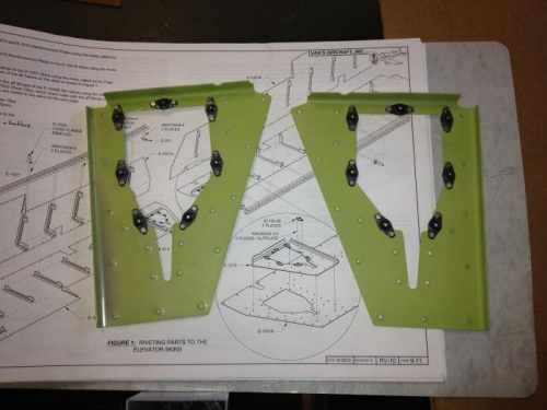

Right completed
Right completed
Job done on both
