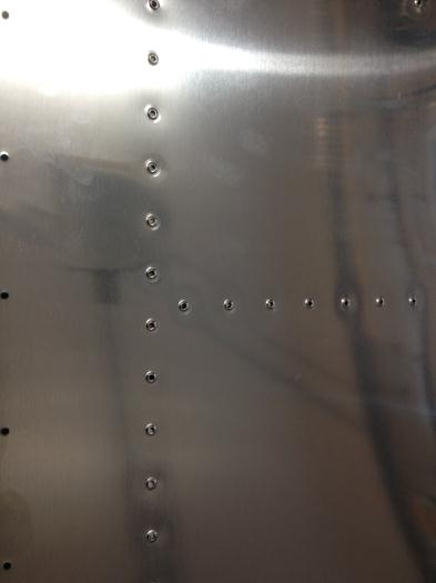

Brief Description:  Deburring and Dimpling
