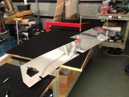

The horn attachments are straightforward.
I am using the IFYRV10 Trim Cable Anchor Brackets which do not have the same size base plate as the originals. You therefore need to place the original in position get a measurement to the front edge of it, then use that as the basis for placement of the after market version. Not very hard.

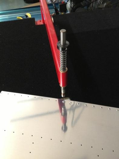

I had a minor problem with dimpling the reinforcement plates unfortunately, I dimpled the top nutplate nearest the flange using my pneumatic squeezer with the standard 3" yoke in it. Unfortunately, it bent the flange slightly throwing the nutplate out of alignment. So I spent the next hour thinking about and fixing the problem using the bench vice, seamers etc. Very annoying. All I needed to do was reverse the tool and all would have been fine. Very annoying, but no harm done.

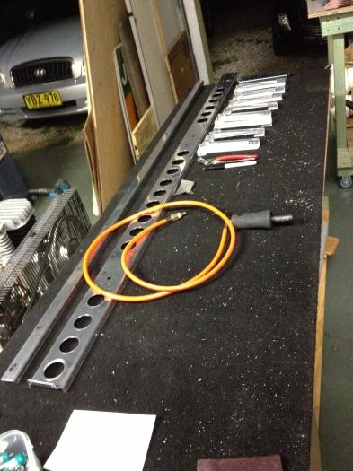

Having completed the build, everything comes apart again and deburring all the holes starts. There was 4 hours on this particular occasion...
