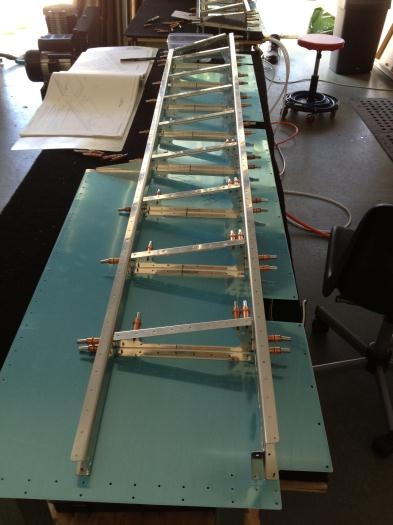

Date:  1-30-2013
Number of Hours:  0.75
Manual Reference:  9.5.2-4
Brief Description:  Adding Spars and Shear Clips.
Completed adding the Front and rear spars along with the shear clips today. Care needs to be taken here to read the instructions. I kept on refereing to the section on riveting to ensure I understood what was happening. The connection of the rear spar to the Root rib is done using AN426-3 rivets so and while the instructions clearly express the fact that you should not drill to #30, they are not good at explaining why...
