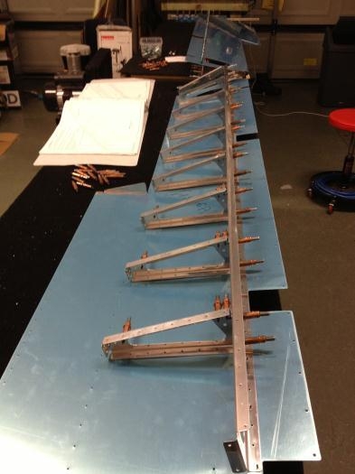

Brief Description:  Clecoed the Ribs to the skins
Final activity for the day was to start putting the structure together. It is one of the best parts of any of the component builds, getting the structure into place for the first time... The description of the positioning of the second side ribs could do with a little clarification. The ribs are installed upside down to allow the flange to be facing outboard. Page 9.11 gives the right picture....
