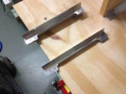

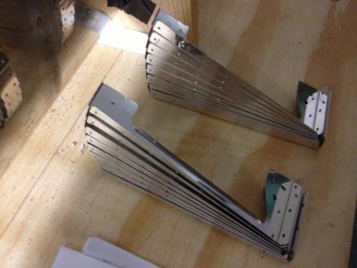

I continued this evening deburing the elevator ribs. Firstly ran them through the linisher to clean up the edges, then ran the E-1008A parts through on the scotchbrite wheel. You can access almost the entirety of these ribs with the wheel, so they just need a bit of a fine sand and they will be ready. The E-1008B parts will need a bit more work by hand tomorrow to clean up the internal edges where the wheels can not reach. These parts are well designed and there shoud be no edge distance issues on them.
Two piles of E-1008A parts
Two piles of partially completed E-1008Bs
