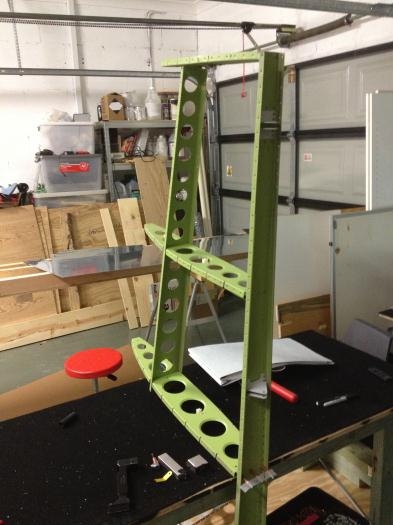

Brief Description:  Riveting VS Skeleton
After riveting the top rib, I integrated each of the pieces for the skeleton and shot the Top rib and the Middle inspar and front ribs. For the time being, the bottom inspar and front ribs are clecoed to facilitate access to the middle ribs when skinning. Getting access to the rivets next to the flanges is interesting. They are quite close. I found it easiest to shoot them with the 3x gun.
Rear view of the VS Skeleton
Front on view of VS Skeleton
