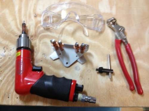

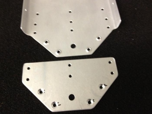

I am running my pneumatic squeezer at 90psi and it squeezes very well, however the dimples in thicker metal have a very rounded edge to them. As a result, when countersinking the front spar doubler, the dimple would not sit into the countersink as well as I would have liked leaving a fine but visible gap between the sheets. When I tidied up the dimples with the C Frame, the edges of the dimples were much crisper and the parts fit together like a glove. The spar is quite thick so I am guiessing that this is the issue. I used Cleaveland dimples in both tools, so no difference there.
I then set to work and cleaned up the rudder stops. They are much smaller than you would expect them to be... The cleaned up well on the scotchbrite wheel.
Front Spar and Doubler Countersunk/Dimpled
Parts ready for final drilling
