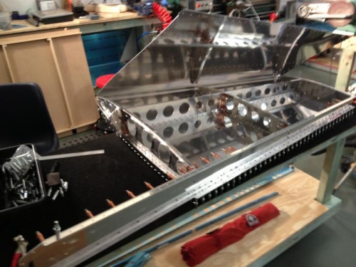

Brief Description:  Added VS Skin and Commenced Match Drilling
I completed the initial installation of the skin and commenced the match drilling.
I found that the skin installed best if I clecoed at the base of the aft spar first then the aft front spar. From here I moved to the front spar at the tip then the aft spar. I then positioned the middle noe rib and added a cleco to the middle of it. From there, everything was lined up and the rest of the clecos went in with no trouble. I then flipped it over and did the same routine, without the need to adjust the middle nose rib.
The first side of the match drilling took about an hour to do.
Skeleton added to the VS Skin

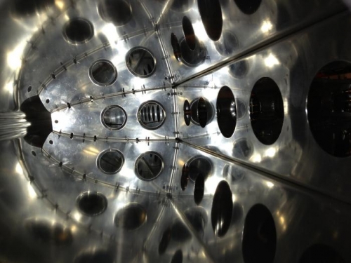

Looks Ok Inside
Looks Ok Inside
