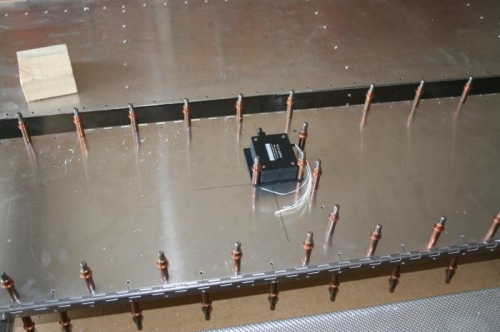

layout rivet lines for elevator trim servo
drill servo attachments and cleko

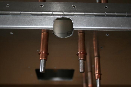

found centerpoint in trim channel flange and cut hole for control rod

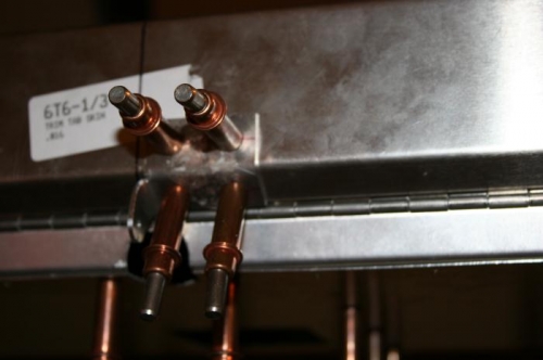

on trim tab horn, drilled pilot holes, alligned on centerline and drilled and cleko'd
