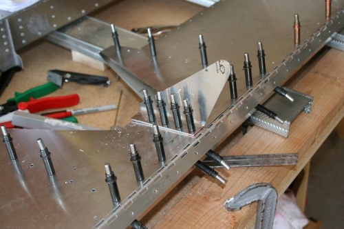

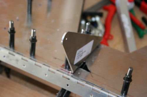

Brief Description:  attached elevator horn
attached the horn to the elevator. when lining the hole up with a straight edge, found the horn had to be moved aft a bit. again, holding while drilling was difficult. to make it easier, i pre-drilled pilot holes into the horn before drilling it to the elevator. I marked its outline once alligned with aircraft centerline and square to the trailing edge, then drilled.
