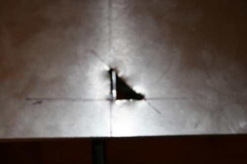

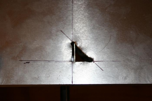

Brief Description:  attached the angle 6t3-7 to the elevator
attaching the angle to the inside of the elevator was not easy...had to mark it on the outside, draw the rivet line, outline the piece, mark the drill locations, and then pilot drill the elevator skin. once that was done, i lined up the angle with the drill marks inside the elevator, held it as best i could and drilled while trying not to drill my fingers!
