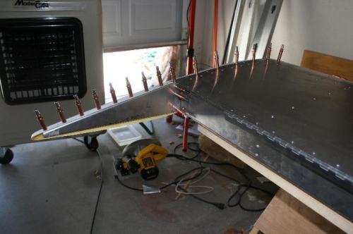

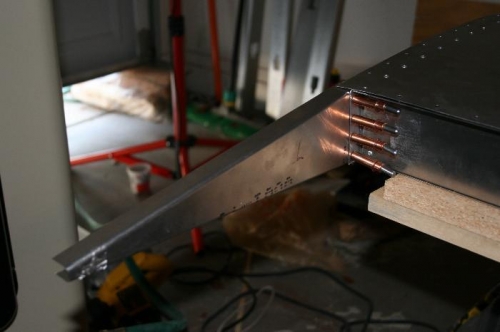

Drilled the FTT Ribs to the Stabilizer. 4 A4 rivets as per the instructions
Fitted the Fiberglass to end rib, and extended the rivet line down the Fiberglass tip.
Marked the rivet holes for the trailing edge at pitch 40 as per instructions. Started at the aft tip, and moved forward. Last rivet before the stabilizer skin was less than 40.
Ensured the FTT rib was square to the spar.
Drilled the fiberglass tip to the stabilizer and FTT rib.
