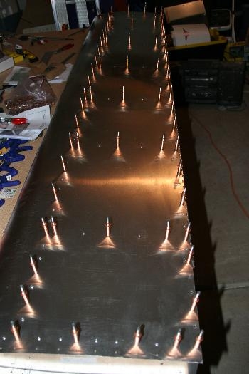

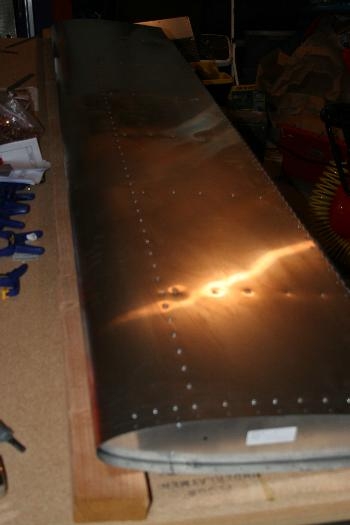

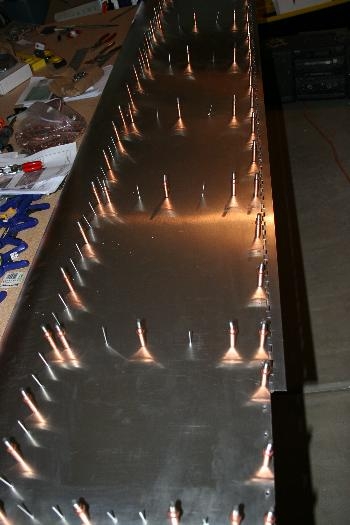

Reassembled H-Stab and riveted
Reassembled The Horizontal Stab.
Placed Cleco's every third hole.
Riveted in between all cleco's.
Removed cleco's and riveted remaining holes.
Note: Did not rivet the rear spar, as the Elevator hinge will be installed after the Elevator is complete.
