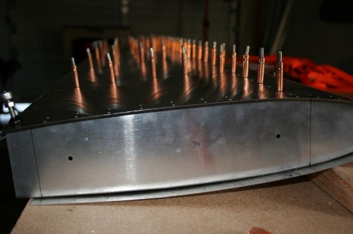

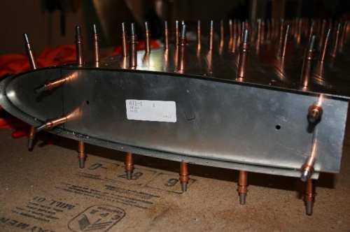

Brief Description:  Installed End Ribs
First I marked the Rivet lies on the L angles, making sure to extend the line to the skins.
Then I placed the Rib onto the end, and made sure the rib was flush with the top spar.
Once in place, I transfered the rivet line from the skin to the rib on top and bottom.
I again removed the rib, marked the rivet lines.
On the L angles, I measured 8mm in from the top and bottom for the rivets, and then measured that distance from the skin. Tose measurements were transfered to the tip rib to mark the rivet points.
Then I replaced the End rib, and lined up all the rivet lines from rib to skin, clamped it in place, and drilled and cleco'd the L-angles.
Once the L-angles were complete, I drilled and cleco'd the rib rivet line on the skin (both sides).
Once done, I marked the bottom aft corner of the Spar line on the rib flange.
I again removed the end ribs, and trimmed the aft bottom corner, making sure to file a corner relief hole.
