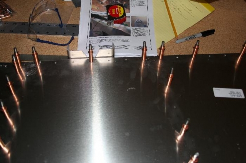

drilled elevator bottom skin
Lined up rivet lines under pilot holes and drilled.
started with rear spar, then ribs, then front spar.
removed the skin, deburred, cleaned and painted for reassembly
