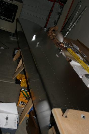

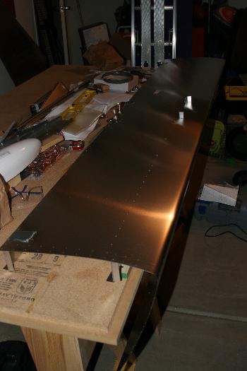

Braced the Skeleton onto the Bench and placed Skin
6-T-1C pg 7, 8 6-T-2A pg 1-4
Placed 1x2 furring strip on the bench to support the front spar.
placed blocks to brace the rear spar.
ensured the spars were level, and the ribs were square to the spar.
removed the Skin from the box.
(note that slots were predrilled in the skin for the front spar braces.)
placed skin over skeleton and alligned with centerline of rear spar.
Alligned with rivet lines, and duct taped in place.
