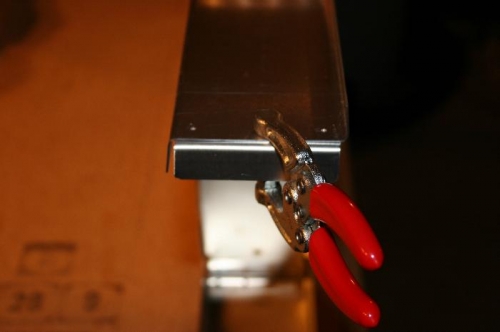

Brief Description:  Attached the L Angles to the spars and drilled out
Attached the L angles to the Spars, ensuring 2205 mm distance between.
Drilled and cleco'd
Opened all drill holes (that are supposed to be A5) to the A5 size (note: the instructions do not say to put 4 a4 rivets in the outboard rib, but the drawings showed them to be A4 size, so thats how i left them (A4)
Tapered the corners of the front spar L-angles to fit inside the end of the rib.
