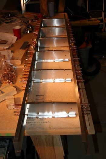

Drilled Ribs to Rear Spar and made 4 L - Angles

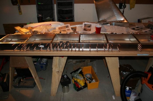

Calmped the rear Spar to the ribs (one at a time)
Drilled and cleco'd each rib to the rear spar.

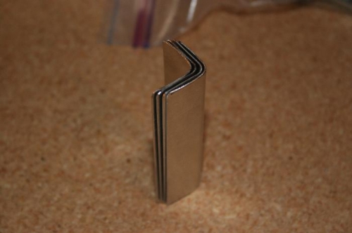

Cut 4 75mm L angles out of the 4 ft L angle length. Rounded the corners with a flat file.
